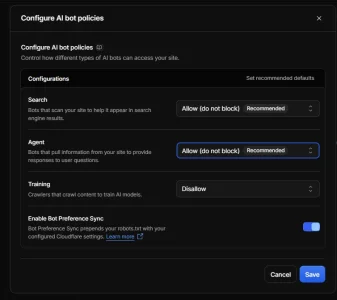

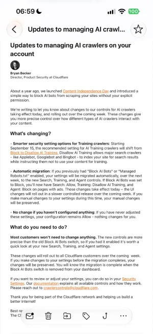

The latest from Cloudflare regarding the mixed-use bots, from today's email:
I am blocking as many CF confirmed bot categories as I can right now, so these new settings will help me fine tune my rules a bit more. In fact, I was about to update my robots.txt with a lot of these changes and turns out, CF automatically added what I wanted, and then some. No it doesn't cover the rogue bots, but these will tame the confirmed bots somewhat.
A sample of the settings:
