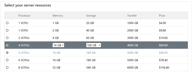

Have you looked at Contabo? https://contabo.com/en/vps/ pretty cheap VPS plans with more than enough specs to run your forum size. The only thing you have to do is offload your email if using domain email, to something else, otherwise if already using a free email provider, no issue. Now you are likely to get crap support, non-existent, whilst they say 4 cores, selling crowded servers is likely their thing, so you will get mixed results on your availability, no different than most cheap shared hosting, but the cores and RAM are more than needed for your small forum.
Install Centminmod and run NGINX with the latest MariaDB, let it run for a week and tune the hell out of it, and you won't have to touch the server again. As your site grows and maybe you want to use ES for search, those small plans have what you need for that, being RAM. NGINX is simple and fast. You lock it down to CF IP's only and that takes care of the majority of your issues, all to be managed via CF going forward.
The caveat, not as simple as Cpanel, but cheap and you get more specs, just need the initial setup, then there is no need to worry about the server much further.

I would be wary of Contabo. I've had numerous attacks (DNS flooding/poisoning/reflection, HTTP probing/exploiting, Email spam/probing, port flooding, and DDoS based attacks) originate from their ASN (AS51167) over the past decade - and it still continues to this day. They show minimal to no desire to proactively filter / stop the malicious activity.
I would recommend Linode or Digital Ocean over Contabo. Contabo is excellent for their price-to-perf versus Linode and DO, but that $/perf comes at the expense that they have toxic IP ranges, and many providers have their whole ASN marked as toxic or are harshly filtering them.

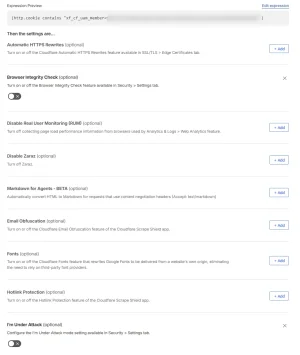

Here's a question.
My first rule in my five CF custom rules includes an instruction to whitelist the xf_user cookie. Meaning, if a user stays logged in, they should never see a challenge. Or at least, that's what I want it to do.
(http.cookie contains "xf_user")
Action here is "Skip."
Yet I still have users saying they get a CF challenge 30 minutes later.
Is this the right way to do it?

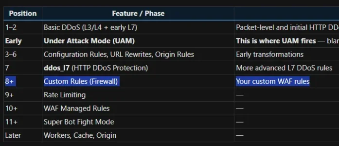

If it's a UAM challenge then from what I could gather it fires way before the security rules.
PositionFeature / PhaseNotes
1–2Basic DDoS (L3/L4 + early L7)Packet-level and initial HTTP DDoS protection
EarlyUnder Attack Mode (UAM)This is where UAM fires — blanket JS challenge on all requests
3–6Configuration Rules, URL Rewrites, Origin RulesEarly transformations
7ddos_l7 (HTTP DDoS Protection)More advanced L7 DDoS rules
8+Custom Rules (Firewall)Your custom WAF rules
9+Rate Limiting—
10+WAF Managed Rules—
11+Super Bot Fight Mode—
LaterWorkers, Cache, Origin—

Yeah, i'd rather have a provider do all that for me tbh, if possible.
I'm still looking around and weighing my options. I have used digital ocean in the past for a game server, but that didn't need anything like cPanel.
digital ocean
The ASN of Digital Ocean is easily within the top 20 ASNs worldwide where continuous scraping attempts come from and there is absolutely no chance recognizable. So obviously they don't care and are thus part of the problem. Why would you give your money to a company that has part in creating the problem that makes you search for a new provider?
CF custom rules
One common trend we've seen so far is that all the problems are members using their iphones on safari. Nobody else has a problem.
UAM is too drastic to keep on all the time. We only did it when we were so overrun with bots a year or two ago that it brought the server down.
As far as 3-6/Configuration Rules, etc., I would have to recheck those but even there, I can't see anything really wrong. Not unless Bot Fight Mode has gotten out of hand (no idea where that falls in this list). These members are getting a challenge every 30 minutes. That is not something I have set, that I know of.

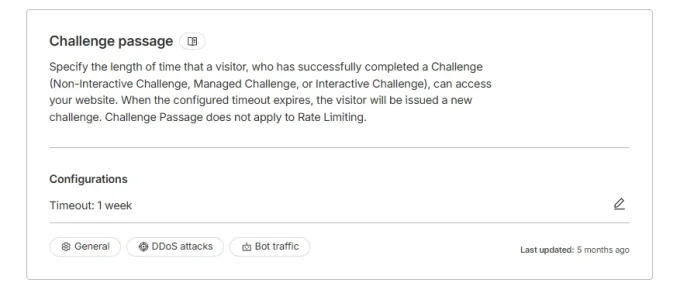

If members are getting challenged every 30 minutes, change the challenge time in your secuity settings, I have mine at a week.
You can change that.
  • Log into dash.cloudflare.com
  • Select your domain
  • Go to Security → Settings
  • Scroll down to find "Challenge Passage"
  • Click the edit/pencil icon and set your preferred duration
Edit: sorry, missed the above by Z3.
