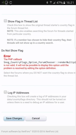

Logging isn't enabled in the options

Back in August you were getting an error on your site related to the reader.php file and I sent you a special file in a PC to log what was happening. And if you got the error again you were suppose to send me the log file.
Evidently you haven't gotten the error again and the log file has continued to grow. Upload the standard library/Snog/CountryFlags/Listener/Includes/Reader.php file that is included with the add-on to stop that log from being written to. You can safely delete the log file.
