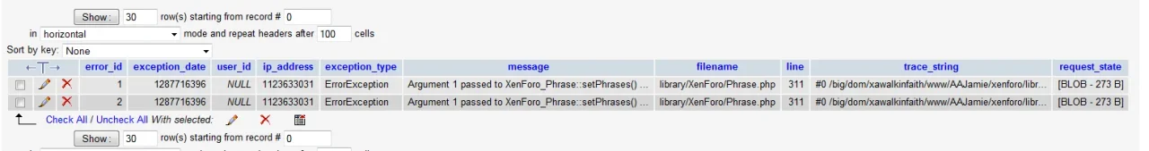

My php log had no errors in it, however in looking through the database using phpMyAdmin I found this entry in the xf_error_log table:
I don't know what it means though.. :eek:

But you know .. it's showing the user id to be NILL, that could throw MySQL in an error if the table is set to not accept nill values...
That could be the reason why the script hangs hmmm ... just a thought
Jamie
I would think it's doing that because it's a brand new install. Right now, until I get it installed and set the admin account, there isn't a user id is there?
