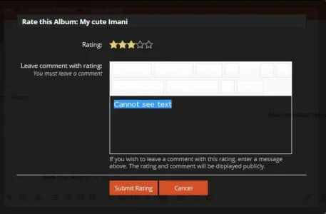

When doing a rating in the XF Media Gallery the popup option looks like this. @Chris D I am not sure if this is something I need to do on the Media Templates or it is a style issue here?
