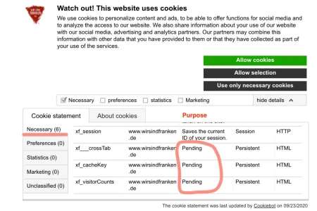

Thank you for your feedback Chris. Unfortunately, Cookiebot (my consent tool) displays these three "cookies" as "cookies". If I now define this as "necessary" and thus do not give the user the opportunity to deactivate it, I have to be able to explain the purpose. Don't you have a brief explanation here? Similar to the others?

There's no issue in telling you what they're for, but they are not cookies. The tool is wrong. I've seen a few threads from them and they insist on conflating local storage with cookies which, in my opinion, is fundamentally incorrect.
There are some fundamental differences between local storage and cookies. Are they unaware of the difference? Technically incapable of distinguishing them? I'd honestly recommend using a different tool just on that basis to be honest.
__crossTab is to enable cross-tab communication of the favicon state and alert counts. It means that when the visitor counts update, it can communicate with the other tabs in order to tell them that the counts have updated. Notice the (1) in the tab title disappears when the alert I have has been marked as seen.
View attachment Screen Recording 2020-10-15 at 09.33.48.mov
cacheKey is a unique key to facilitate caching within the PWA functionality we added in XF 2.2. This is not currently used but it would allow commonly accessed resources to be cached in order to allow some access to the site when it is unavailable.
visitorCounts the aforementioned "visitor counts" are kept in local storage. They indicate how many unviewed/unread alerts there are, how many unread conversations there are and the time it was last updated. Every time a request is performed, the data is updated and it is used to update the red counts above inbox / alerts in the header.

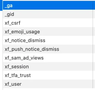

Using Firefox Storage Inspector these are cookies listed for my site:
Hey Lucky, oh man :) these "cookies" (if there are any) are again not displayed to me with Cookiebot. That doesn't make it any easier now :)
Some of them may be optional.
emoji_usage stores your most recently used emoji if you use the emoji popup in the editor.
notice_dismiss keeps track of the notices you have dismissed on the site so that the ones you have missed are not shown again.
push_notice_dismiss tracks your dismissal of the "XenForo community would like your permission to enable push notifications." notice.
sam_ad_views this isn't set by us and is presumably from an add-on.
tfa_trust is if you have set up "Two-step verification" and have opted to "trust" this device. This is to stop you from being asked to repeat two-step verification every time you log in.

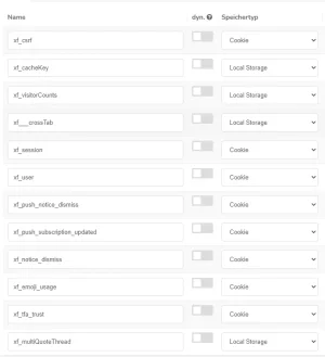

Is there perhaps a complete listing of cookie and local storage elements that are used?
Currently I have this list:

The above list is (at least) missing
Cookies
  • xf_ls (used as fallback if LocalStorage is not available)
  • xf_session_admin (backend only)
  • xf_edit_language_id (backend only)
  • xf_edit_style_id (backend only)
  • xf_style_id (frontend, used to store selected style for guests)
  • xf_language_id (frontend, used to store selected language for guests)
  • xf_from_search (used to track the search engine a user came from)
  • xf_inlinemod_post
  • xf_inlinemod_profilepost
  • xf_inlinemod_thread
  • xf_inlinemod_xfmg_media (only w/XenForo Media Gallery)
  • xf_inlinemod_xfmg_album (only w/XenForo Media Gallery)
  • xf_inlinemod_xfmg_comment (only w/XenForo Media Gallery)
LocalStorage
  • fr-copied-text
  • fr-copien-html
  • xf_multiQuoteSelection
  • xf_multiQuoteThread
  • xf_editorDisabled
  • xf_push_history_user_ids
  • xf_guestUsername
  • xf_lbSidebarDisabled
Also missing (both local storage):
  • xf_multiQuoteConversation
  • xf_multiQuoteMediaItem (only if XFMG is installed)
Questions:
  • I could not find xf_cacheKey on my machine. What is it used for / when is it set?
  • I also do not get a xf_from_search cookie, when I visit the forum from Google. Reason?
  • After how many days/weeks/months/years will xf_tfa_trust expire? On my machine it is set till the year 2072. 😲
