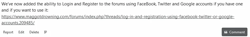

Just bringing this back up, everything works as it should do on my forum however when a link is added to a Profile Post it remains just that, a text link.
Is there a way of setting it so that it displays a hyperlinked page title instead of just a text link?
How it displays now:
193749
Thanks,
