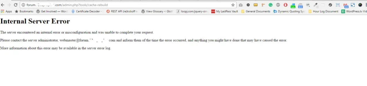

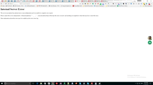

Hey I am getting the 500 Internal server error while using the convert image all addon.
Please help me to solve this issue.converimageadmin.webp converimagepublic.webp

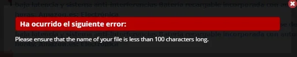

I tried to convert them into attachments but it doesn't work.
Do you know why? I can only think of two reasons:
a) not working at same domain
b) too long image
Thanks in advance!
PD: probably second reason:
"Please ensure that the name of your file is less than 100 characters long."
I'd like to test it with a higher value but have no clue of where to change it. Just google it and still without ideas :(

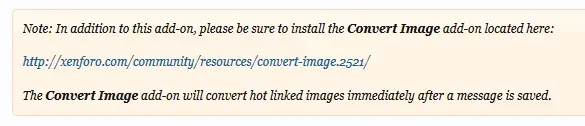

I assume the Convert Image add-on came first, allowing attachments to be converted as they are uploaded to posts - and then afterwards either Andy (or someone else) thought it would be great if you could go back through all your prior attachments and run the same process on them ... hence this extra batch "All" add-on. (y)
TBF it does say you should install the Convert Image add-on here:
... but it doesn't specify that it is essential/required, and so I ignored it on the basis I would look at this "other" add-on after I had completed the batch conversion.
Perhaps it should be more explicit and say it is REQUIRED to make this batch add-on work? @AndyB
No, this add-on needs Convert Image to be installed too (I figured this out when trying to use this add-on solo when I migrated to https). (y)
CORRECTION: Actually, I'm wrong. This add-on works independently of the other - my mistake. I remembered having issues when I first installed it, but @AndyB kindly reminded me that it was an issue on my server, not a problem with the add-on (I'd installed the "common" Imagik package, but not the core files). :oops:
b) too long image
Thanks in advance!
Solved after enabling "Follow redirects" :)
