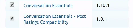

I just installed 1.10.1 via ChrisD's addon install/upgrade and it automatically ran the postratings xml also, and I know for a fact that I had not done this prior, but it still shows 1.9.0 on ACP for the main addon, can you check the version string in the file?
The add-on install/upgrade add on likely installs the first xml file it comes across. Manually install the other one. It's the right version, I checked.
Good to know. I checked and all the files had been uploaded on the server so I am just running the xml.

@The Sandman I used Chris D's installer to install 4 addons all in .zip file format, and ConvEss was one of them, it uploaded the files but only ran the post likes compatibility addon. I had to run the ConvEss main addon separately, now it shows the correct version.

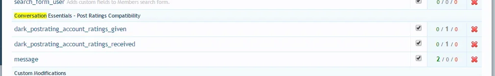

Sorry if I'm missing something here, one the compatibility XML is installed, do we need to do anything else? I can't see anything listed in the instructions, but I'm not seeing the post ratings in the conversations.
EDIT:
Doesn't look like the template modifications are being applied.
Or am I missing the point entirely, and it won't actually show the post ratings??
