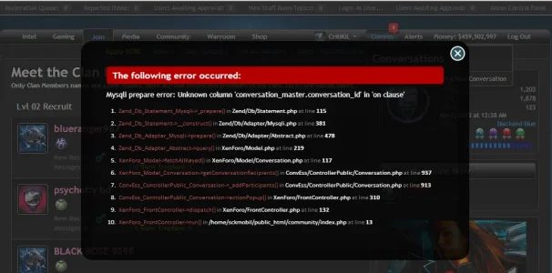

I just upgraded to XenFo version 1.1.4 today and there was a message in the Convo which I never opened. Upon finishing the upgrade from 1.1.3 to 1.1.4, I tried to open the Convo and I recieved this error:
Please advise on how to correct this? Thanks in Advance ;-)

Well, it had been off. I just tried to enable it, and got this error:
Fatal error: Maximum execution time of 30 seconds exceeded in /home/domain/public_html/forum/library/XenForo/Template/Compiler.php on line 1126
This is weird. When I got that, I used the dropdown menu (like you would if you wanted to hit uninstall). When i clicked the checkbox, it reenabled. Then, when I reloaded the page, it disabled itself again.
Try disabling other add-ons one at a time, then enable/disable this one to see if you still get the error.
My only guess is that another add-on you installed is causing this.
Alright, I've gone through and deactivated every single ******** add-on, and uninstalled the ones that wouldn't deactivate, and it still won't work. 36 total. After every single one, I tried turning it back on, and I'd reload the page and it would turn off again.

Got this working again. I had uninstalled the whole thing (from ACP, then folders from server), and was told to try out all my add-ons on the test site. So I did. About half way through, everything was working fine, and most everything I had left to install weren't going to interfere, so I figured '**** it' and tried it again on the main site. Installed smooth as silk. Been a few days now and its still holding strong. Still no idea what FUBARED it in the first place, but if you're having issues, try a complete uninstall and reinstall.
This is a typical xenforo phenomenon. I had this all the time. If your test installation is on an apache server, get rid of it and use nginx. With nginx add-ons activate/deactivate much faster. There is a rule of thumb here. The more templates are involved with an addon, the more time it takes for the addon to activate/deactivate.
Another solution would be to increase the execution time. And finally, a third solution is to repeat the activation/deactivation process till the addon has been completely activated/deactivated. Addons are actually activated/deactivated in chunks if your server is not fast enough.
