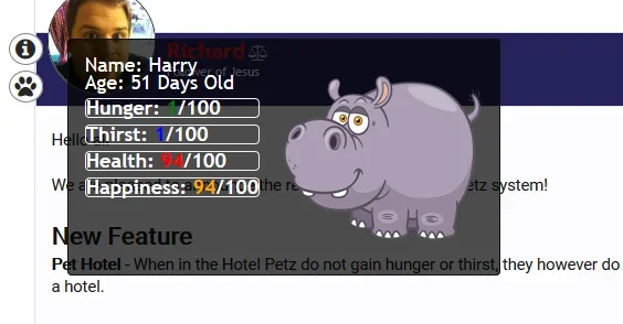

It shows the correct info per user, hippo.webp, but when making a new post it causes a "console error" yet not error shows in the console.
any suggestions anyone? the error only occurs when the template (foreach) code in, so not a direct controller issue i presume, but rather something related to the param in the controller?:)

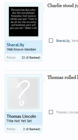

update it only breaks postbits/avatrs for those without pets, is there a way to could wrap above in a IF that could avoid that?
update 2 more of a round up of info the hackey direct edit of the core file doesnt cause this issue, so clearly my model extend wrong somewhere
Made some changes with help of a well known dev here, both of us think it looks right, but still the error persists. (in basic while pet data loads and message info loads as normal for all with pets, for those without pets they lose all info, styling, avatar etc)

Sharalily has a pet so her styling remains, thomas does not.
width the Model listener active.

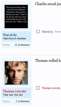

with it Disabled the styling returns
the addon consists of just 2 files., a listener and the model (as the pet data pulled from tables created by a seperate addon) so the error exists somewhere in my model file, but we cant see what it is.

is working
