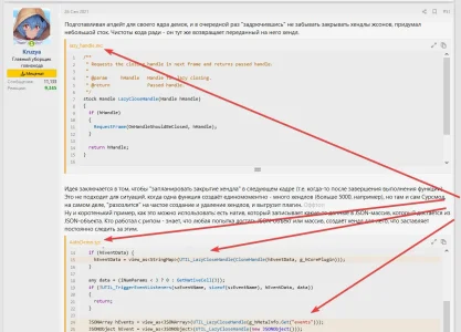

Unfortunately, in your free add-on user can't set custom title for code block and highlighted lines:
Attached to this post fixed version for 2.2.7. Changes can be viewed here (mixed with _data and hashes.json deleting from original author with updating _output, sorry :().

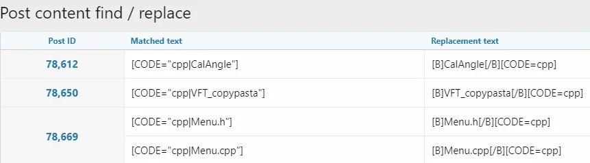

Here is the regex to fix it using the "Post Content find / replace" Xenforo plugin.
DO NOT USE THIS UNLESS YOU KNOW WHAT YOURE DOING AND DOUBLE CHECK EVERYTHING, YOU COULD POTENTIALLY SCREW THINGS UP. BACKUP YOUR DATABASE FIRST
REGEX:
/\[CODE="([a-zA-Z]{1,20})\|(.{3,100})"\]/
REPLACE:
[B]${2}[/B][CODE=${1}]

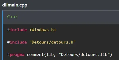

Should look like this:
It simply takes the old title and bolds it, in a line above the code blocks and makes the syntax highlighting work.
Looks like this after you run it:
This query took a very long time on my board which has 10k + code blocks. I had to run it a few times because it timed out.
