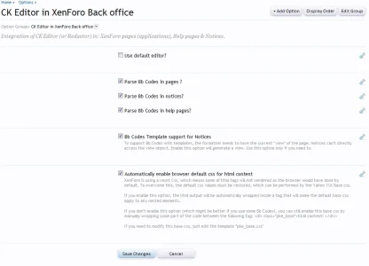

Preview of 1.3 version on Github:
  • Add CKE/Redactor for notices and help pages
  • Same thing for Bb Codes support
  • Fix extra breaks (<br />) when using Bb Codes in html
  • Redactor html wysiwyg with white space between lines (after a cariage return)

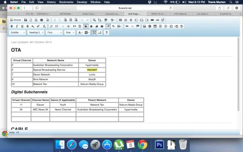

Any reason why a page i format like this:

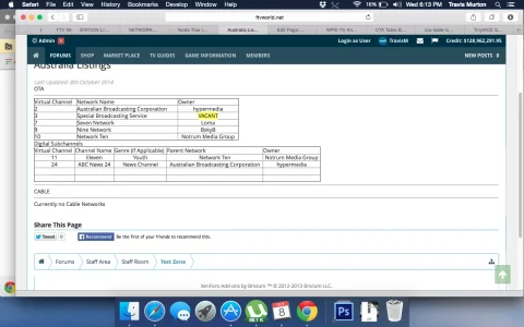

Looks like this when saved:
Any help much appreciated!
@Travis,
