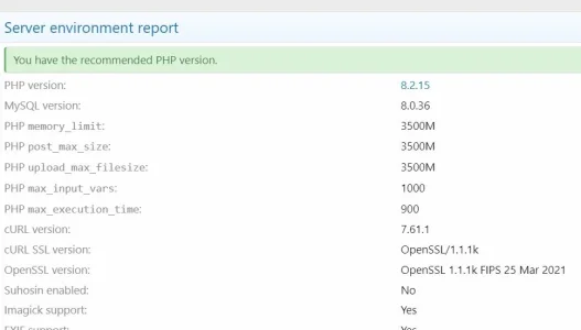

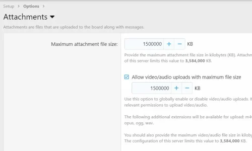

So I set the max upload size in PHP to be 25600M and see it reflected in phpinfo, but I'm still receiving a generic error from XF: "The uploaded file is too large for the server to process.". Is there another setting to set outside of upload_max_filesize?
You need to setup the chunk size as well. The maximum chunk size should be at or below the upload_max_filesize value.
Max chunk size is below upload_max_filesize.
Checking the Virtually increase maximum attachment file size option worked, but not sure if I should leave this :/

Yeah, leave it on and run your tests. That is the option to enable the addon. :)
Ah, interesting. So checked "Virtually increase maximum attachment file size" means use chunked uploads. Unchecked, it goes back to XF behavior?
