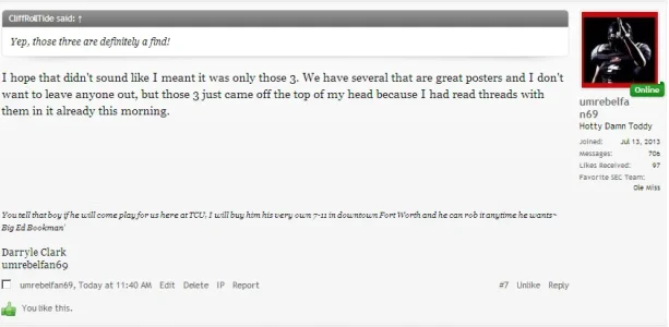

I thought this could be done in extra.css but it ended up just adding an additional icon beside the original heart.
How can I change that heart to a thumbs up, a checkmark or something besides that!

I just looked, I don't have anything in extra.css that would leave a heart.

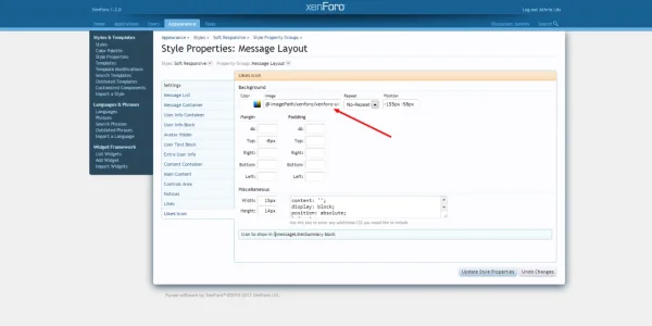

Style Properties, Message layout, Like Icon :)
Upload the image you want and change the url to suit and remove/change the positioning to suit whether it's on a sprite sheet or a single image
Ok, so I uploaded an image I want to use, changed the url, erased the left padding and I get nothing. Just the names of people who like the post, no icon.
