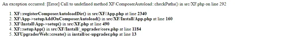

R RisteDimitrievski Active member Dec 18, 2021 #1 Current version: v2.2.2 Upgrading to: v2.8.1 patch level 1. Any idea to resolve this?
Chris D XenForo developer Staff member Dec 18, 2021 #2 Upgrading the old fashioned way will workaround this. Upload the 2.2.8 Patch 1 files from your customer area and run the upgrade manually. This is a known issue but doesn't affect everyone. I'll look at smoothing out the bumps. Upvote 0 Downvote
R RisteDimitrievski Active member Dec 18, 2021 #3 If i download xenforo v2.8.1 and upgrade to 2.8.1 then running via forum install to patch level 1 should this work? Upvote 0 Downvote
P Paul B XenForo moderator Staff member Dec 18, 2021 #4 You should just upgrade directly to the latest version. Upvote 0 Downvote
