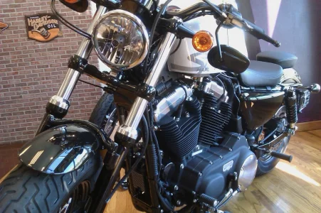

The only way I can successfully upload anything is to disable the Flash Uploader. I'd like to re-enable it if possible. Tested it here and it appears to work.
