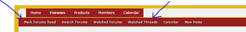

T Money Active member Sep 17, 2015 #1 Hello XF: I am trying to change the font color of the navigation bar menu: As you can see I already changed it on the SP/Navigation Tabs Container: For some reason the default blue won't change. Any advise would be appreciated. Thanks

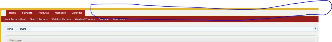

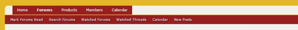

T Money Active member Sep 17, 2015 #5 Thank you. New problem: the background color on the navigation tabs bar is not continuous for the entire row, how to fix this? And how can I get rid of the orange line in between the top and bottom nav bars? And how to edit or remove the bottom nav bar menu? And how to edit or remove the bottom nav bar menu? For example get rid of "New Posts" menu. Attachments upload_2015-9-17_10-30-26.webp 7.4 KB · Views: 1 upload_2015-9-17_10-32-37.webp 7.4 KB · Views: 1 Upvote 0 Downvote
