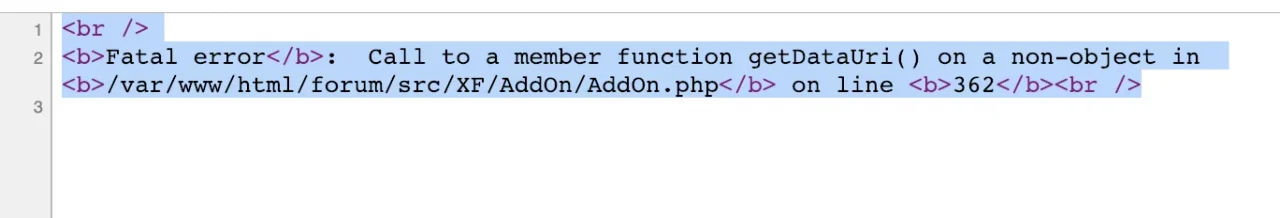

I have recently changed my XenForo Server, but when I imported it, I can't access on Admin CP with this error:
Fatal error: Call to a member function getDataUri() on a non-object in /var/www/html/forum/src/XF/AddOn/AddOn.php on line 362
Thanks for reading
I can see the Admin CP login screen, but when I log in, it display me this error
Hello everyone :)
Thanks for reading
This is definitely indicating that you have inconsistent files. You can likely go to <url>/admin.php?tools/file-check/ and run the check which should show this.
If it doesn't, then that would indicate that you have an aggressive opcache setting which has cached the old versions of the files. You'd need to clear this, likely by restarting the PHP server.

I believe we have identified a PHP 5.4 specific issue that causes this. If possible, we would strongly recommend upgrading to at least PHP 5.6 as that's what 2.1 requires anyway.
If that's not possible, we may be able to identify a manual patch to apply.
