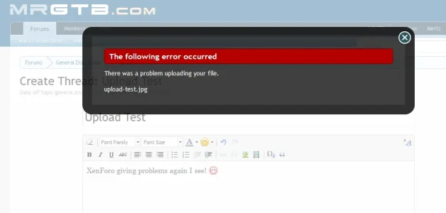

I've done a clean install of XenForo today, 1.1 final version.
I cannot upload files (images). I've added the line to config trying both 0755 and 0644. No joy! It becoming extremely frustrating using XenForo of late.

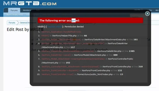

Your directory permissions are incorrect.

The mkdir seems permissions, the other ... there is definitely something wrong, I was having the same issue on a fresh install of XF just today.
I gave up, I just disabled the flash uploader in the options, it defaults to the form html upload. It works fine now for me. Does the flash uploader do temp upload somewhere?
There's something wrong here. OK, I managed to get images uploading now. The problem was I changed this line from 0755 to 0644 in the config.php file.
$config['chmodWritableValue'] = 0755;
When at 0644 in config, I didn't first spot it created an attachment folder in "internal_data" with 0644 permission, so XenForo couldn't write to it (upload to it) obviously. I solved that problem by deleting attachment folders in internal_data and data folders, changed chmod permission in config back to 755 and uploaded image again (worked fine). But there is another problem here going on. When I delete the image from forum and then check those two attachment folders. They are still there, they have not been deleted from the folders (even using 0755 permission on them).
