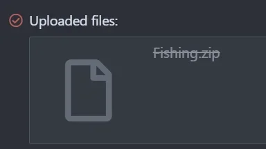

Whenever trying to upload a Zip file I get an error after it gets to 100% and sits there for a little. The error says undefined, and I have everything set up.

Sometimes it doesn't even give an error and simply has this for the file...

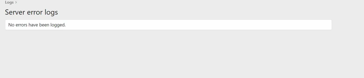

I guess it'd help to also put this too:
I'm not getting any server errors, so I'm completely confused.
