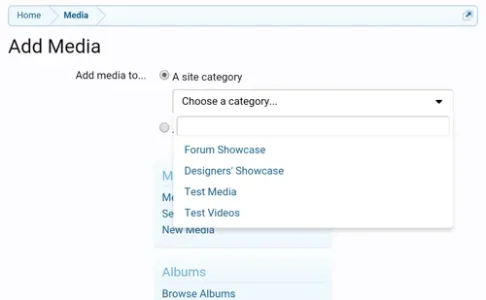

I have a Sony Xperia Z3 compact tablet running Android 5.1.1 and I have discovered that, when adding media to the Gallery, I cannot select the category or album that I want it to go in. When I tap on any of the categories, they briefly change the background colour as though they are being selected but almost immediately return to their original state.

I'm really stuck though with my Xperia Z3 compact tablet though (the Xperia Z1 phone is fine as long as I don't request desktop mode). I have no idea why it just highlights a category very briefly but won't select it. Multiple taps and heavy presses just will not select a category.

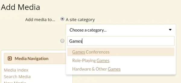

Incidentally the workaround for this is to start typing in a category until it highlights it (as shown below). Then hitting return selects the category, allowing media to be added to the category.
