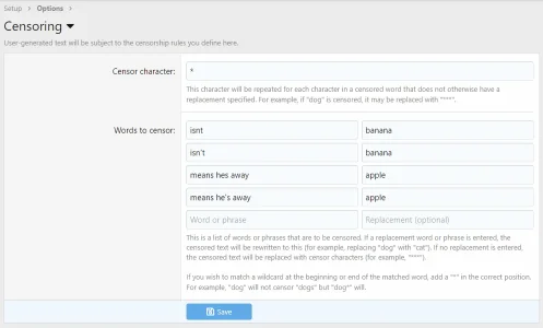

I add the following phrase to the censor list - means hes away - and it if anyone types "means hes away" it gets censored correctly. If however I add in a second version of the phrase using an apostrophe showing omission - means he's away - then the ones who use correct punctuation and type "means he's away" do not get censored.
It doesn't matter if I use a wildcard to replace the apostrophe, or if I use the wildcard to remove "he's" completely, the version of the phrase containing the apostrophe slips past the censor.

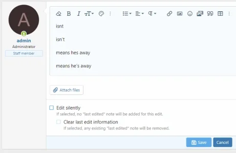

I know, but the second one does not work when input into the censor list. It seems to confuse it somehow.
So in your picture above, the first entry works, and censors that exact text on the forum, however the second entry does not work, and will not replace the exact text on the forum.
I have no doubt it does, just doesn't on our installation. Seems the majority of people use the former, working apostrophe so I am happy to have identified the issue at my end so we can deal with the hundreds of posters that think it is absolutely hilarious to post that phrase in every thread regarding a player :D
