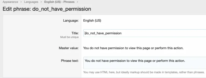

I'd like my free members to upgrade to access paid-for resources. But at the moment, if they speculatively click on a link to one of these to see what it's all about, they see,
Oops! We ran into some problems.​
You do not have permission to view this page or perform this action.
Dead end. It would be nice to replace that with some directions explaining how they can access it. Is there a feature or an add-on for that?
Very good idea, thank you! I've jumped in and done that, and yes, it is possible to add links.

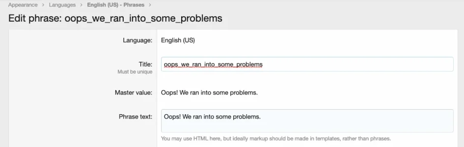

Hello @Hilary,
You can try this code in your error template (replace all the content with this code) :
HTML:
<xf:title>{{ phrase('oops_we_ran_into_some_problems') }}</xf:title>

Change the usergroup ID in $xf.visitor.isMemberOf(2) to match your need
Change the "To access to this resource..." phrase to match your need too.

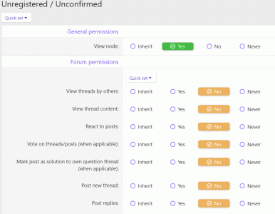

Thinking about it a bit more, you might try to set up your permissions differently. Your paid forums aren't visible at all, unless you have paid to access them. I see you link them through navbar, but I can't see forums at all.
If you would make forums (ie nodes) visible, but content visible only with subscription, then notices will work.node setup.gif
Of course, first take notice how did you set it up previously, so you can return in case it wouldn't give you desired results.
I will definitely try this next, thank you!
And now that those forums are visible, interested people are more likely to purchase subscription when they see that there's some private content.
