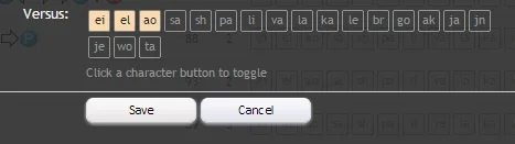

I've created some custom buttons (toggle yes/no) for use in a form:
There are 19 buttons in total, with the first 3 selected ('yes') as shown.
The javascript function to handle the toggle functionality works as desired, changing both the appearance (class) and value (hidden input) on click:

This function is registered for each button. In the cases where all buttons need to be enabled, rather than have the user click 19 times, I would like to have another button that performs a Toggle All functionality.
Essentially, I'd like to call the XenForo.Foo.ToggleYesNo() function multiple times when a (new) button is clicked. To do this, I created a new button button with the following function, ToggleAll, registered:

But this doesn't work. I need to somehow trigger the on-click within the AppliesYesNo() function multiple times (for every button).
Any help with the above would be appreciated.
