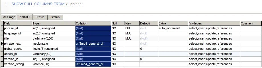

You can verify the table's collation by running the following SQL command:
SHOW FULL COLUMNS FROM xf_phrase;
Yup that's what i have,
and i still get the same error.

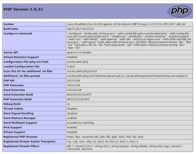

Can you report on the Configure Command section as seen in the PHP Info?

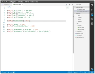

@Pur3x & @Titans you both need to add the following line to your config.php for the add-on to work:
$config['fullUnicode'] = true;
