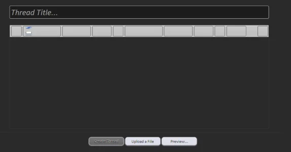

So the editor buttons for bb codes are not showing up for one and that one is in the wrong spot as shown in the picture any solutions on whats wrong and how to fix it?broken.webp
It looks like the icons are missing from your custom style.
If so:
There are some new and updated images so if you have a custom style directory you will need to copy those to the relevant folders.
They are:
You should check these threads if you have upgraded.
http://xenforo.com/community/thread...nt-information-and-actions-to-be-taken.56027/
http://xenforo.com/community/resources/how-to-upgrade-to-xenforo-1-2.2397/
http://xenforo.com/community/resources/how-to-upgrade-to-xenforo-1-3.2810/
the icons.png is in there thats why the 2nd image there is showing
Fresh install?
Custom style?
If the former then it should not be as the files would be the correct ones.
Latter then your style has not been updated (either fully by you if it's your developed style with custom location for it or by the author) for 1.2.x -> compatibility as the icons.png has changed as @Martok indicated in the post for you to review.
