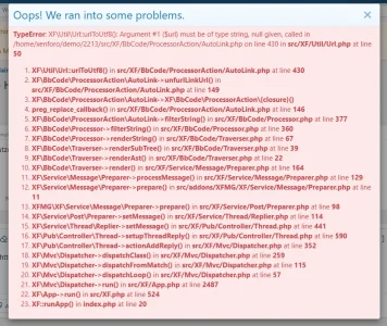

Broken autolink and error message: TypeError: Argument 1 passed to XF\Util\Url::urlToUtf8() must be of the type string, null given, called in /src/XF/BbCode/ProcessorAction/AutoLink.php on line 430 src/XF/Util/Url.php:50
XF\Util\Url::urlToUtf8() in src/XF/BbCode/ProcessorAction/AutoLink.php at line 430
XF\BbCode\ProcessorAction\AutoLink->unfurlLinkUrl() in src/XF/BbCode/ProcessorAction/AutoLink.php at line 149
XF\BbCode\ProcessorAction\AutoLink->XF\BbCode\ProcessorAction\{closure}()
preg_replace_callback() in src/XF/BbCode/ProcessorAction/AutoLink.php at line 146
XF\BbCode\ProcessorAction\AutoLink->filterString() in src/XF/BbCode/Processor.php at line 377
XF\BbCode\Processor->filterString() in src/XF/BbCode/Processor.php at line 360
XF\BbCode\Processor->renderString() in src/XF/BbCode/Traverser.php at line 67
XF\BbCode\Traverser->renderSubTree() in src/XF/BbCode/Traverser.php at line 39
XF\BbCode\Traverser->renderAst() in src/XF/BbCode/Traverser.php at line 22
XF\BbCode\Traverser->render() in src/XF/Service/Message/Preparer.php at line 164
XF\Service\Message\Preparer->processMessage() in src/XF/Service/Message/Preparer.php at line 129
XF\Service\Message\Preparer->prepare() in src/addons/XFMG/XF/Service/Message/Preparer.php at line 11
XFMG\XF\Service\Message\Preparer->prepare() in src/XF/Service/Post/Preparer.php at line 98
XF\Service\Post\Preparer->setMessage() in src/XF/Service/Thread/Replier.php at line 114
XF\Service\Thread\Replier->setMessage() in src/XF/Pub/Controller/Thread.php at line 441
XF\Pub\Controller\Thread->setupThreadReply() in src/XF/Pub/Controller/Thread.php at line 590
XF\Pub\Controller\Thread->actionAddReply() in src/XF/Mvc/Dispatcher.php at line 352
XF\Mvc\Dispatcher->dispatchClass() in src/XF/Mvc/Dispatcher.php at line 259
XF\Mvc\Dispatcher->dispatchFromMatch() in src/XF/Mvc/Dispatcher.php at line 115
XF\Mvc\Dispatcher->dispatchLoop() in src/XF/Mvc/Dispatcher.php at line 57
XF\Mvc\Dispatcher->run() in src/XF/App.php at line 2487
XF\App->run() in src/XF.php at line 524
XF::runApp() in index.php at line 20

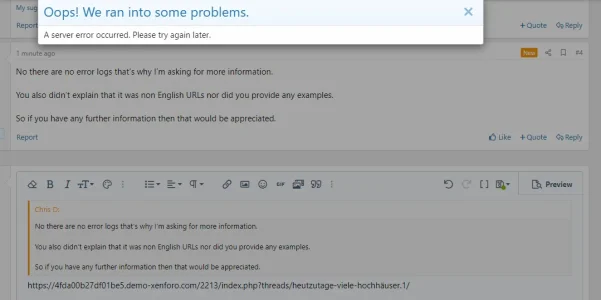

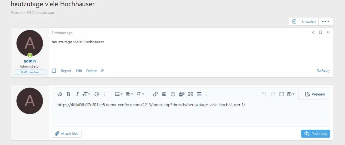

https://4fda00b27df01be5.demo-xenforo.com/2213/index.php?threads/heutzutage-viele-hochhäuser.1/#post-1
Here is the url copied from the forum demo, if we send this link in a message, we will receive a message, as in the screenshot above. Also on the demo forum I inserted a link to the topic in the message, we see an error.
And accordingly, an error is raised for links that contain non-English words.

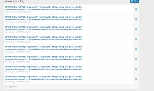

It is somewhat related to the fact that the code has been changed, and as I understand it, the string formatter was modified, which simply checked the URL and had the following code:
if (!\XF::app()->validator('Url')->isValid($url))
Without the check:
$url = $validator->coerceValue($url);
Now it has appeared, and the attempt to convert addresses is made. So we have the following behavior:
When it should be transformed into the URL as follows:
heutzutage-viele-hochhaeuser.1
But we removed the URL conversion in the validation:
PHP:
// romanize and deaccent to allow all accented chars to be considered valid
$value = utf8_romanize(utf8_deaccent($value));
And now, when it comes to checking the link, the value is set to "invalid." This is because a link like "heutzutage-viele-hochhäuser.1" does not pass the validation filter_var($value, FILTER_VALIDATE_URL) and return empty string. This is because FILTER_VALIDATE_URL does not support IDN in any form, meaning it does not support domains like "rødgrød.dk" or "xn--rdgrd-vuad.dk," even though the domain is active.
PHP:
$validator = \XF::app()->validator('Url');
        if (!$validator->isValid($url))
            $url = null;
Due to this code and the failed validation, the URL is being set to null, which is causing the error you mentioned.

#20 src/XF/App.php(2487): XF\Mvc\Dispatcher->run()
#21 src/XF.php(524): XF\App->run()
#22 index.php(20): XF::runApp('XF\\Pub\\App')
#23 {main}
Request state​
array(4) {
["url"] => string(42) "/threads/2023-saturday.42857/reply-preview"
["referrer"] => string(56) "https://xxxx.com/threads/2023-saturday.42857/page-6"
["_GET"] => array(0) {
["_POST"] => array(10) {
["message_html"] => string(81) "<p>https://xxxx.com/threads/a-huge-thank-you….255660/</p>"
["attachment_hash"] => string(32) "39628949ec09f800d1d5e0bfd0f3ddc4"
["attachment_hash_combined"] => string(87) "{"type":"post","context":{"thread_id":42857},"hash":"39628949ec09f800d1d5e0bfd0f3ddc4"}"
["last_date"] => string(10) "1685251481"
["last_known_date"] => string(10) "1685251481"
["load_extra"] => string(1) "1"
["_xfRequestUri"] => string(35) "/threads/2023-saturday.42857/page-6"
Is there more specific reproduction cases? It doesn’t look like we can reproduce it here.
Here's the issue:
  1. \XF\BbCode\ProcessorAction\AutoLink::unfurlLinkUrl calls \XF\Str\Formatter::prepareAutoLinkedUrl.
  2. prepareAutoLinkedUrl returns an array containing url and linkText. If the URL is deemed invalid, url is null.
  3. unfurlLinkUrl immediately passes the url and linkText values to \XF\Util\Url::urlToUtf8 without checking whether they're null, even though url is expected to be null at times.
