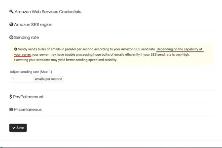

ok, here is another question for Sendy:
In the setup I saw this:
I thought that Sendy is sending via my Amazon SES account and therefore the limits on my server do not apply at all ? Do the sever limits still apply?
Messages still have to be transferred from your server to Amazon SES. If you have a very high sending quota at SES and a very small server this may be a bottleneck which you can solve using that setting.
Usually you do not need to adjust your sending rate in Sendy,
Do you mean that if I have a treshold of i.e. 1000 emails every 10 minutes on my server, but a lot higher on Amazon SES, I just put in the field above (emails per seconds) a higher number and the bottleneck of my server is gone?
