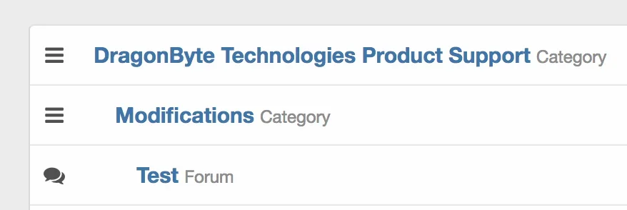

Consider the following structure:

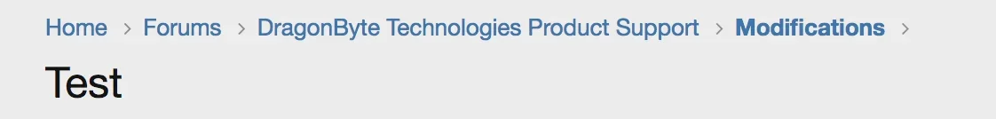

Expected result:
I would expect to see "Home -> Forums -> DragonByte Technologies Product Support -> Modifications" when viewing the "Test" node.
Actual result:
I see "Home -> Forums -> Modifications" when viewing the "Test" node.
Fillip
Interesting. I can replicate it on my local computer, but not on the test imported installation.
