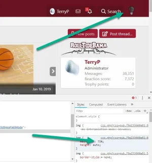

It works beautifully, Brad.
Where can I adjust the size? Playing around, 75% fits my style easier.
Hey I just got your message. I added a class in the container on the next release to make it easier. But for now you could add this to the template extra.less which is where all your css changes are supposed to go.
CSS:
.p-nav-opposite img {
max-width: 75% !important;
Also I wanted to add that you could opt. for a font awesome light bulb if you preferred that. I added the image in just in case someone liked it better or wanted to put their own image in place of it. Check style properties if you preferred the font awesome version. I'm currently working on a new feature requested by @Upgrayedd to add a toggle switch with some text to show when the lights are on or off. I should be releasing it before too long. Let me know how that works out for you
@Upgrayedd I updated my code. The class .p-nav-opposite appears more than once. So that code if you add it to the template "extra.less" will fix your issue. The code I posted before would make it where they all disappear. This will stop it from appearing in those areas.

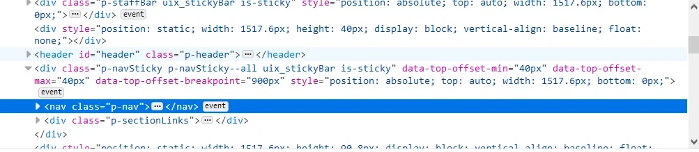

That does work, but the option to have it appear to the right of search does not work with the UI.X styles. It appears to the left, regardless. Just so you know.
Something else must be going on then. The right of search option uses the exact same class and the only difference is a simple float: right and float:left. I don't see how that would be specific to a UI.X style. If you go to where its supposed to be over in inspect element does it show the div/image at all? I'm willing to fix it I just need more info
This is all I see where it should be:
197442

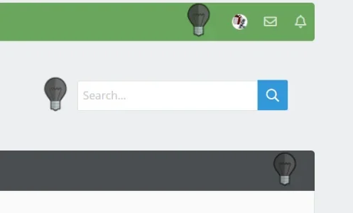

But also I've found that there's other problems with other TH styles. I use their Classic style, for example, and see this, even with the recommended code in extra.less:
197443
I'm wondering if an option to just position it somewhere else might get around problems with some of these styles, at least the TH ones.
I have a copy of UI.X 2 for 2.0.x
And @Upgrayedd was able to send me the PAGE_CONTAINER code so i could post an update. I could probably just add an option that you could check if you had UI.X styles and then it would put the items in the appropriate places. When I finish this new feature I was adding I will update it with that option so it will work on UI.X styles. I will update it soon and let you know
