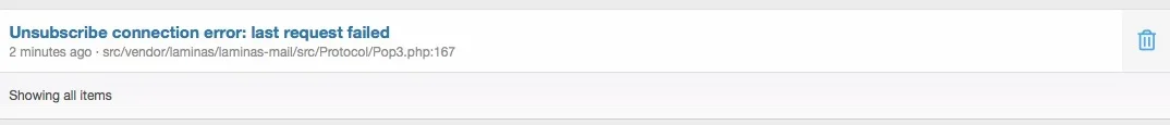

BasilFawlty, I looked up your new error and it is indicating it either cannot connect to the server, or else that the authentication is not working. Might be worth connecting to email via your webmail or something like outlook just to confirm that you can connect to the mailbox and that the email and password are working.
Seeker-Smith, with those errors on SSL for you, perhaps try changing it to TLS on port 993.

My email transport method is set to SMTP using SSL with port 465 and normal mail from the server works fine. UPDATE: I changed the bounce and unsubscribe settings to what you are using and that seems to have fixed the issue. No more errors. Thanks!!
