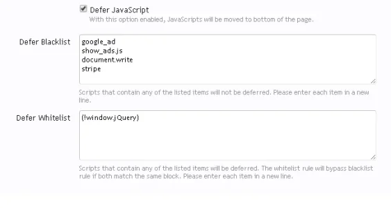

Ok, the iframe blocking was caused by a browser plugin so the console errors are resolved... however, still no stripe button.
I see a the div with id=stripe and a form in the code but it only has hidden fields. Can you tell me what I am missing?

Do you use [bd] Cache or something similar? If so you'll need to make an exception for Stripe to work, xfrocks did it on my forum and it worked.
Ok Zynephix..... can you tell me what exactly you entered in the blacklist / exception as I cant seem to make it go :P
I'm not using bdcache but I am using a defer javascript mod. It has exception / blacklist function but I'm unsure what to put in there, could you take a look in your settings?
Thanks,
Rob
No worries and you can thank xfrocks, he sorted it within seconds of taking a poke at my forum lol

Do you use [bd] Cache or a similar add-on? If so you need to whitelist Stripe, I think I have a reply further back for it.
