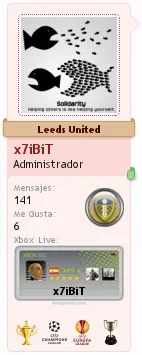

I would like to add a box (border) where the awards would be. How can I do that ?
Great add on btw.
Great add on btw.
There are a few places where they appears. You may need to take a screenshot and point it out so I (or other members) can help you
I mean a border around all displaying icon. I tried to add html but it doesn't works.
You didn't specify if you want to add a border in the post or not. But I assume that. You need to edit the template name "bdmedal_message_medals", you can use HTML there

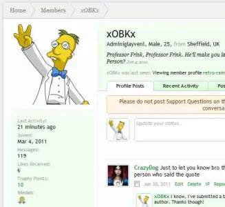

Having bumped into the discussed profile tabs problem (overflow), I'd like to see the Medals use a similar approach to Trophies.
ie. Instead of using a profile tab, as space is currently finite until Kier and Mike come up with a solution between them, place the medals on the left sidebar with the hook member_view_info_block and use the same overlay that is used on message_user_info.
The attached screen is photoshopped, but I do plan on coding it unless you beat me to it.. ;)
