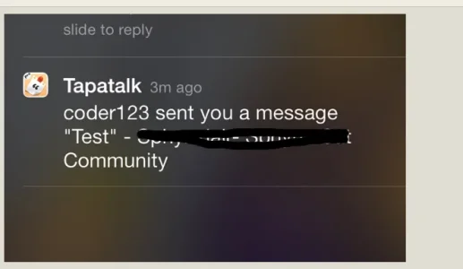

This is really strange, i sent myself a PC from a test member i created to test an email and another member got it to as did i? The add on is off by the way as of this morning but this same meber said the same thing yesterday with add on on. any thoughts? It was on Tapatalk if that would even matter.
The receiver is an admin or something? There is an option to forward all mails to an address FYI.
I have just read the part about Tapatalk, it's a push notification and not emails. You will need to ask that member about his/her Tapatalk app configuration and such.
