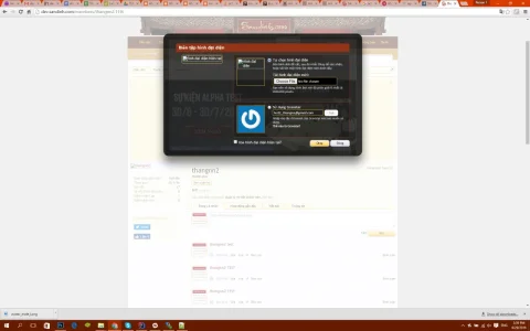

Hey Xfrocks!
We purchased your addon and install on our local Xenforo dev site. After Install and set this code to config file:
$config['bdDataStorage'] = array(
array(
'type' => 'ftp',
'host' => '',
'username' => '',
'password' => '',
'path' => '',
'url' => '',
'port' => 21,
//'passive' => true,
'backup' => 'data',
with info to my FTP.
After install and move data files from data to the directory on the server I see the avatar show well however I cant change the avatar. I loads and tell successfully uploaded the file but avatar not changed.
Also I cant logged out user after the plugin installed.
Please could you help?
Thank you.

Hey Xfrocks!
array(
'type' => 'ftp',
'host' => '',
'username' => '',
'password' => '',
'path' => '',
'url' => '',
'port' => 21,
'backup' => 'data',
Thank you.
