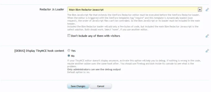

Since you have an easy way to test if it would work or not, could you please test this release (I don't have time and I don't use Redactor on my live boards):
https://github.com/cclaerhout/xen_BBM_v2/archive/master.zip
There's a new option about what we've talked (in the Buttons Manager options):
Thank you so much. I've tested this version.
As you have said, "Included the Bbm Redactor loader will add only a few bytes of code, but included the main Bbm Redactor Javascript is the safest solution." Because If I chose "Bbm Redactor loader", sometime it not work.
Thank you again !!
Thank you again !!
Thanks for your feedback. That's strange I've made the test more then 20 times (x2) with another addon that sent me a developer to test a kind of similar problem that had TinyMCE before and it worked every time. Anyway since the default option is to load the full js, that should not be a problem.

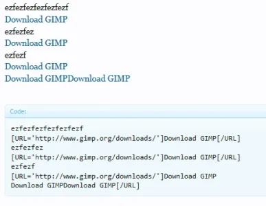

I am having problem with BBCode...
[URL='http://someplace.com']Some place[/URL]
I write to entries using the URL bbcode
  • the first line will output as expected.
  • second line output text without conversion
If is deactivate BBcode Manager, everything works.
Test message

I can't reproduce the problem on my boards. See the screenshot.
