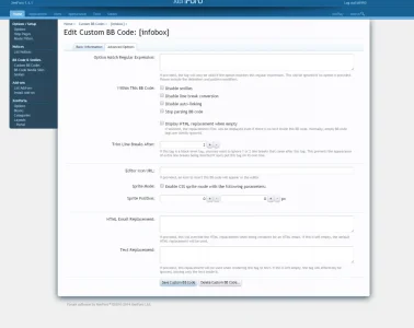

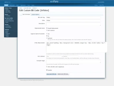

Uploaded screenshots of the [infobox] tag I often use and is the one which messes up mostly.

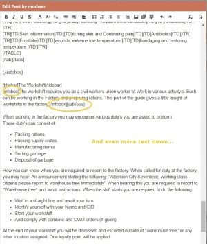

Last screenshot shows how it suddenly decides to open/close the tag again, and sometimes it's even more than just once, it's like up to 3 times, and at the end the infobox is not closed at all....
I've tried to disable RTE and edit it - to save it, but it actually does the exact same thing then as well.

That said, there appears to be a font change surrounding the tag close and open in the last screenshot, so I'm pretty sure that is the mis-nesting issue. You can look at using the remove formatting button on certain areas to clean that up.
