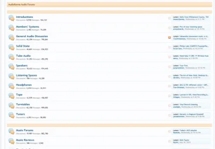

I just did a clean install of Xenforo and imported the data from vB3.8.8. The forum nodes imported in the correct order and correct node categories but have these blank bars periodically. How do I remove these from the Admin console? Is it in the node tree?

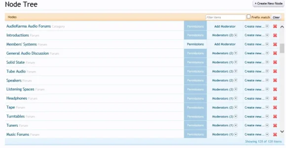

Can you screenshot what the node tree looks like in the control panel?
Specifically, I think at least "Music Forums" is a forum at level 1, with things like Music Reviews under it. You may also have other forums at level 1, where the bar just works as a divider to help separate them.
The more common setup involves categories at level 1 and forums under.
I have never used Xenforo before (last 12 years with vB), so getting up to speed. I have done nothing with the node tree yet. This is how the import set things up. The top bar is set category and the rest are forums for this section. I can redo how these are setup in the node tree if that is what is needed to remove the spacer bars. In vB, the categories were used as forum dividers.nodetree.webp
Right, you're not actually using it as a tree. The dividers that you see are there to separate when things appear to change between "groups" when grouping isn't actually being used.
I would recommend redoing it into more of a tree/grouped structure, such that related forums are under a parent category. I see custom permissions for almost every forum though, so doing this may change how the permissions are calculated (due to custom stuff at the parent level inheriting down, unless overridden).

I will try an explain better. All the categories and forums under those categories transferred in the correct orientation. In the node tree they are designated correctly category and forums. The orange divider bars with writing in them are the correct categories. The orange bars with no writing in them were added by the import process but are not shown in the node tree. I just want the blank orange dividers bars gone.
Ok after some digging around and learning more about the node tree, I have figured it out. The importer set everything under "root node". I need to go through all 128 forums and reassign them to their respective categories. Simple fix, just takes a little time. Chalk this one up to newbie learning the system.
