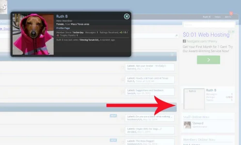

New user avatars are not showing up on their home page on when they post.
If you see the attached image, their avatar is there when I click on it, otherwise not showing up.

Here on post: Nickmanes, Doggie Jail Rescue and Hi Everyone, the avatar is missing on all three
http://www.toydogforums.com/index.php?find-new/111970/posts
If you click any of those like this one, the avatar is not showing up again.
http://www.toydogforums.com/index.php?threads/nicknames.932/
If I right click in the box it shows '404' Not Found
Tried in Firefox and Chrome - BOTH give the same results.
