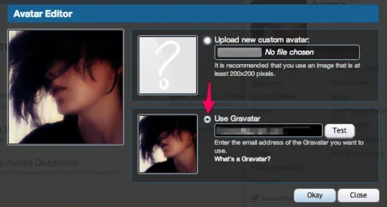

Make sure that your members have actually told XenForo to use their Gravatar. If they haven't chosen to display their Gravatar, then it'll default to RoboHash/Identicons.
The user has chosen to use a Gravatar avatar. They have a Gravatar image on file. If I choose anything in the ACP other than RoboHash then their Gravatar image shows up. If I choose RoboHash then a RoboHash image shows up, not their Gravatar image.
In Listener.php if the ACP RoboHash option is chosen it loads an image from robohash.org, otherwise is uses gravatar.com to load an image. That means if RoboHash is chosen in the ACP then it will always load an image from robohash.org and not gravatar.com. The end result is that users will get a RoboHash image instead of their Gravatar image.
