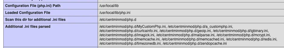

Tracy Perry
Check your php via the ACP and make sure that you changed the correct php.ini. Some panel solutions can have different PHP.ini's that the process reads.
Go to yourdomain.com/admin.php?tools/phpinfo and see what PHP.ini path is being used and make sure it's changed in that .ini file.
As you can see in my example image below... with CentMin Mod it can read data from multiple .ini files.
Under the Core settings, you can see what max file size upload is being used.
