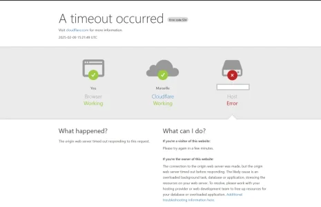

Ok so I downloaded the zip, installing. and this step takes a long time:
"apathy/StyleSuite - Finalizing..."
There's a xenforo orange installing animation so up until this point it's fine. But then at some point the loading animation disappears.
And this happens:
The add-on shows up as "Installed" though I doubt it finished correctly.

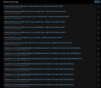

These are the latest errors;
And this happens:
~PIC~
I wouldnt worry about the timeout too much, the assets should continue importing in the background and the timeout shouldn't interrupt the logic flow
Check the db and see if theres __conflict tables, if not then those errors are from your previous failed attempts.
If there are, uninstall the addon again, delete the tables, and reinstall.

Ok I uninstalled it, deleted the tables, reinstalled (it timed out again).
No errors on log. I think I might be good?
Should be good to go!

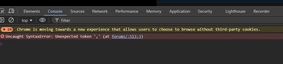

@apathy is this just me?
<script>
XF.ready(() =>
        XF.extendObject(true, XF.config,
                apSsAvatarFrameStyle: 'square',
            "svStandardLib_time.day": "{count} day",
works for me, check if you have any JS minifiers / defer scripts or settings set.
Mine doesnt say "XF.ready()" though, not sure where thats coming from for you
<script>
window.addEventListener('DOMContentLoaded', () =>
</script>
I think it's related to Standard Library by @Xon ?
The issue is the extra comma, full code on page:
I have that addon as well and it's working fine so I'm uncertain that's the issue.
If you have no JS minifiers etc set up in the likes of Cloudflare or other addons then I'd start disabling addons one-by-one to see if it persists.
Also, check if it happens on the default theme.
There's no minification that I'm aware of.
If I disable standard library it turns into this: (no error):
<script>
XF.ready(() =>
</script>
If I disable this plugin, the whole block disappears. I was expecting this portion to be there but no:
Odd, I'm really unsure of why that'd be, I've never had an issue running the standard library alongside style suite. I'll try look into it.
Would you add a field to frames to specify a class?
Or maybe allow "grouping" frames and add a class with the group name to all the frames in same group.
So we don't have to edit extra.less to add same rule to a different frame?
I'll try add custom classes into 2.14.0 if possible.
It already allows for inputting custom CSS without having to edit .less templates, but you would be re-specifying the same rules over and over, so I agree custom classes would work nicely alongside this.
Make sure you have updated StandardLib to the latest version as it updates how it injects phrases which doesn't conflict with this add-on
