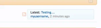

DI... another issue which is pretty blatant, and just tell me what you want sent for this to be fixed, as on the forum home it shows the real username of the person who posted:
It shows correctly the random guest name in the forum view and thread view pages, just not forum home.
Missed one last template edit, my bad - see installation step 5
Is it just me, or is this still an issue? I'm still seeing my real user name in forum home. Edit: I'm posting from my admin account tho. Not sure if that matters ...
Shouldn't be an issue unless you haven't applied all the template edits or your style conflicts
