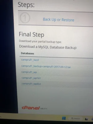

vinnymickey
All I need is data base referenced to Xen correct. Host activated it for me to pull database.

vinnymickey
Just for my own knowledge if I wanted to get the old site to work before the move so we can delete the old site (three) do I upload the database and overwrite? Still very confused how the two sites are working off same database :(
