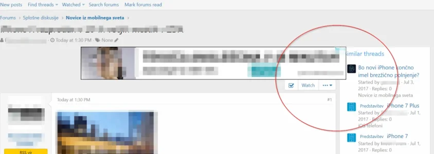

Affected version
XF 2.0 RC2
This happens when I add an ad to position Thread View: Above message list and Container Content: Above (this two I've tested so far) with a widget in Thread View: Sidebar.

Sorry, now I see it shows ok when you're logged out. If you're logged in it shows like in picture in first post of this thread.
I've registered now but I think you might only be showing the ads to guests.
Also, which browser was the screenshot taken with?
Sorry, Chris, I'm just setting up things on that forum... Yes, ads are visible to guests, mods and admins for now. I've set you as moderator now if you check again.
The screen was taken in latest Chrome (cache cleared etc.), but in new Firefox all looks good.

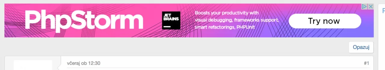

I'm really not certain we can do anything particular about this. It does look different for me. Sometimes it works fine:
It seems to be down to what size ad is loaded in the slot. Sometimes a much wider ad is shown. Though also sometimes an ad is shown but it overflows to the sidebar when it doesn't need to.

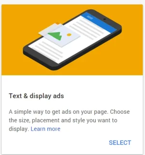

It's this Adsense ad type:
Ad size is set to responsive. It worked fine for me in XF1 in any position.

On my board too the responsive advertise unit covers the full width on desktop.
I see it overlap the sidebar and sidebar content goes bihind it
This happens when my sidebar length is more than forum tree length.
Its a page bottom ad unit.
Also both unit look ugly when they covers whole width of forum.
In both case on desktop, when side bar length increases beyond forum tree length (when more user comes online and threads with big tittles are posted).
Advertise overlap the sidebar, i seen that many time. This happens when full page width ads is displayed, whe their size is less then they do not overlap
