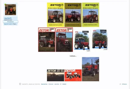

Now I can start working on my PDF archive in gallery style. Litle bit styling work to do, but it works. :)
These are 10 automatic generated PDF previews with a width of 150px - as eg. :)

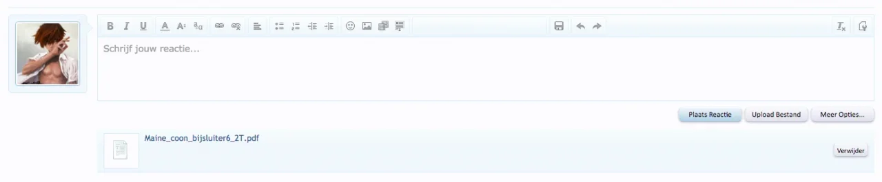

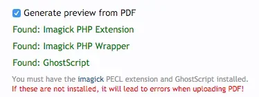

I have both Imagick PHP Extension, Imagick PHP Wrapper and GhostScript installed on the server, but no Preview is created. Bug or am I missing something?

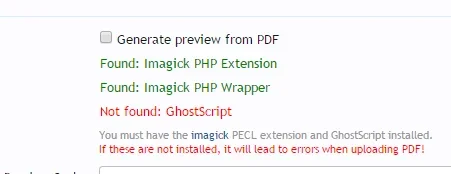

Hmmm, I have all three things installed on server but it shows me that I do not have installed GhostScript, but I have
[root@tvor-ocean ~]# rpm -q ghostscript
ghostscript-9.07-18.el7.x86_64

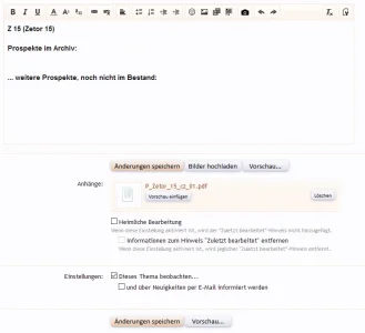

Have you embed the pdf files in a post, or only uploaded? The preview is only to see, if you embed a pdf.

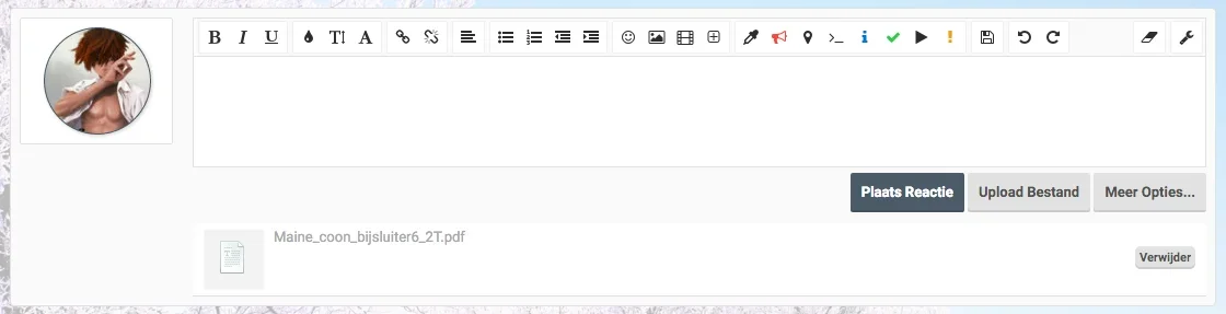

Oh, you dont have the button "insert preview" shown. Any other addons that conflict with?
Normaly it should look like:

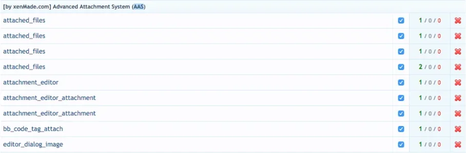

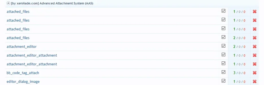

Can you please take a look at TMS system - are all AAS template changes loaded in your style?
I have the same issue with the default style:
I have no idea what the TMS system is and how to check if all AAS template changes are loaded... I only play around with CSS :( Sorry.
I will try to force a reinstall of the addon. Perhaps that works.
