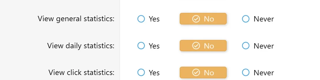

I just noticed a bug when using stat access:
/ads-manager/statistics/116d34f80c46820af0fad115123abc/daily?ad_id=5
if this is my link,
I can change the ad_id and have access to the statistics of any ad I want.
From the usage of the access key I understand the intention was to allow access to only the ads in the key.
Using version 2.4.17.
Was this fixed in a later version?

Are you signed in as an admin?

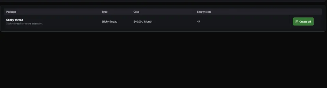

1741542215233.webpI am having issues displaying packages. Only sticky thread are shown whereas I have other packages also listed and available to every user group.

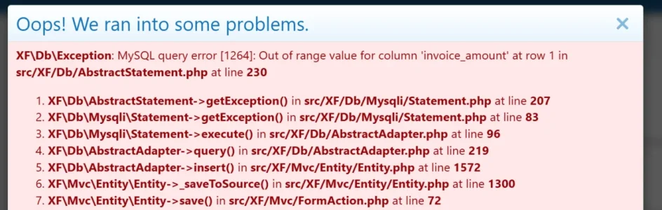

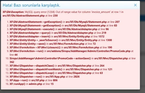

Hello @Siropu

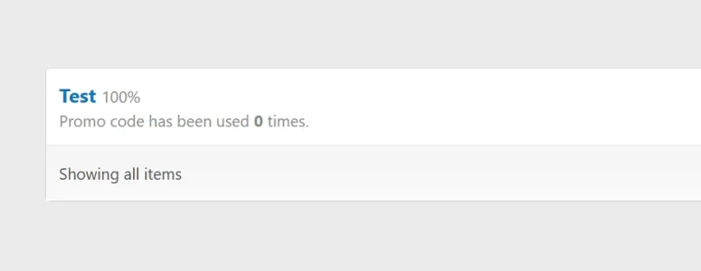

error when trying to create a promo code
This error occurs when an amount is entered here. Example : 1500
XF\Db\Exception: MySQL query error [1264]: Out of range value for column 'invoice_amount' at row 1 src/XF/Db/AbstractStatement.php:230
Tarafından: hakyangler 10.03.2025 09:09'de
Yığın izleme
INSERT  INTO `xf_siropu_ads_manager_promo_code` (`promo_code`, `value`, `type`, `package`, `invoice_amount`, `active_date`, `expire_date`, `user_usage_limit`, `total_usage_limit`, `user_criteria`, `enabled`, `create_date`, `usage_count`) VALUES (?, ?, ?, ?, ?, ?, ?, ?, ?, ?, ?, ?, ?)
#0 src/XF/Db/Mysqli/Statement.php(207): XF\Db\AbstractStatement->getException('MySQL query err...', 1264, '22003')
#1 src/XF/Db/Mysqli/Statement.php(83): XF\Db\Mysqli\Statement->getException('MySQL query err...', 1264, '22003')
#2 src/XF/Db/AbstractAdapter.php(96): XF\Db\Mysqli\Statement->execute()
#3 src/XF/Db/AbstractAdapter.php(219): XF\Db\AbstractAdapter->query('INSERT  INTO `x...', Array)
#4 src/XF/Mvc/Entity/Entity.php(1572): XF\Db\AbstractAdapter->insert('xf_siropu_ads_m...', Array, false)
#5 src/XF/Mvc/Entity/Entity.php(1300): XF\Mvc\Entity\Entity->_saveToSource()
#6 src/XF/Mvc/FormAction.php(72): XF\Mvc\Entity\Entity->save(true, false)
#7 src/XF/Mvc/FormAction.php(190): XF\Mvc\FormAction->XF\Mvc\{closure}(Object(XF\Mvc\FormAction))
#8 src/addons/Siropu/AdsManager/Admin/Controller/PromoCode.php(44): XF\Mvc\FormAction->run()
#9 src/XF/Mvc/Dispatcher.php(362): Siropu\AdsManager\Admin\Controller\PromoCode->actionSave(Object(XF\Mvc\ParameterBag))
#10 src/XF/Mvc/Dispatcher.php(264): XF\Mvc\Dispatcher->dispatchClass('Siropu\\AdsManag...', 'Save', Object(XF\Mvc\RouteMatch), Object(Siropu\AdsManager\Admin\Controller\PromoCode), NULL)
#11 src/XF/Mvc/Dispatcher.php(121): XF\Mvc\Dispatcher->dispatchFromMatch(Object(XF\Mvc\RouteMatch), Object(Siropu\AdsManager\Admin\Controller\PromoCode), NULL)
#12 src/XF/Mvc/Dispatcher.php(63): XF\Mvc\Dispatcher->dispatchLoop(Object(XF\Mvc\RouteMatch))
#13 src/XF/App.php(2826): XF\Mvc\Dispatcher->run()
#14 src/XF.php(806): XF\App->run()
#15 admin.php(15): XF::runApp('XF\\Admin\\App')
#16 {main}

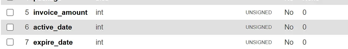

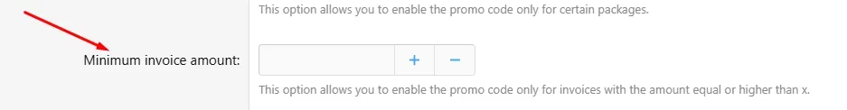

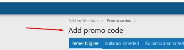

Hello @Siropu
View attachment 320002 View attachment 320003
Yığın izleme
#16 {main}
Durum isteği
array(4) {
  ["url"] => string(39) "/admin.php?ads-manager/promo-codes/save"
  ["referrer"] => string(60) "https://oltamisina.com/admin.php?ads-manager/promo-codes/add"
  ["_GET"] => array(1) {
    ["ads-manager/promo-codes/save"] => string(0) ""
  ["_POST"] => array(14) {
    ["promo_code"] => string(4) "OM50"
    ["value"] => string(2) "50"
    ["type"] => string(7) "percent"
    ["package"] => array(1) {
      [0] => string(1) "6"
    ["invoice_amount"] => string(4) "1500"
    ["active_date"] => string(0) ""
    ["expire_date"] => string(0) ""
    ["user_usage_limit"] => string(1) "1"
    ["total_usage_limit"] => string(1) "1"
    ["enabled"] => string(1) "1"
    ["_xfRequestUri"] => string(38) "/admin.php?ads-manager/promo-codes/add"
confirming
I fixed it by changing xf_siropu_ads_manager_promo_code > invoice_amount to INT
