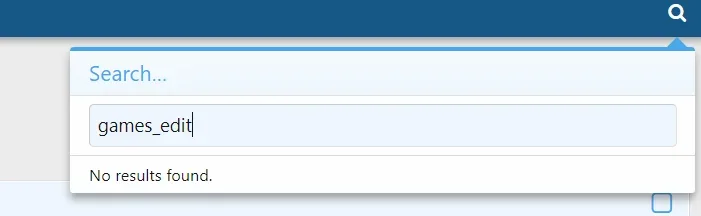

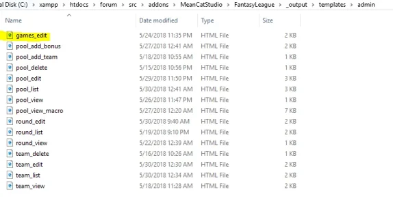

I have installed my addon I have been developing locally on my real server. I have an admin template that I see in the _data folder templates.xml file
<template type="admin" title="games_edit" version_id="1030010" version_string="1.3.0 Alpha">
inside I see this.
But when I try to search this as admin in the admin search, I find nothing.
and I know this is not working because this template is missing.
What could have gone wrong?

I have the output locally.
it seems like all the admin templates are missing :(

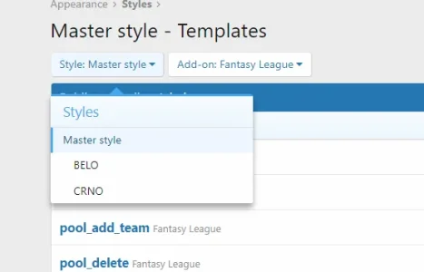

Folks from xenforo, I am not really seeing any admin templates now. I am not really sure what is going on? DO I have to enable develop mode on in order to see the admin templates? I would not like to do that in the live site.
I realized I created these templates in Master Style (whatever that is), and its not part of my styles.
If I switch to any other styles these are not available.
In the main website, I do have 2 styles only, they are pretty much changed style colors of default style. Can somebody help on this? Thanks !!!
I just realized when I comment this out from the local site src/config.php
$config['debug'] = true;
Then I do not see the Master Style either and I do not see the templates as well.
How can I copy the admin templates from the master style (from debug) to my other styles?
Please anybody that can help. I don't have the default style as I deleted it after I created 2 styles I am using from it.
