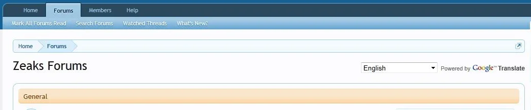

I've added this to my site, but did it a bit different. I added the translate to the right of the forum title as shown in the screenshot. If you don't care for the horizontal look, create your own here http://translate.google.com/translate_tools
Edited template ad_above_content and below the only line there I added
<div class="google">
<div id="google_translate_element"></div><script>
function googleTranslateElementInit() {
  new google.translate.TranslateElement({
    pageLanguage: 'en',
    layout: google.translate.TranslateElement.InlineLayout.HORIZONTAL
  }, 'google_translate_element');
</script><script src="//translate.google.com/translate_a/element.js?cb=googleTranslateElementInit"></script>
</div>
Then in extra.css I used
/* google translate */
.google {
float: right;
margin-top: -35px;
It doesn't seem to be causing any issues with logging in or out for me so far.
